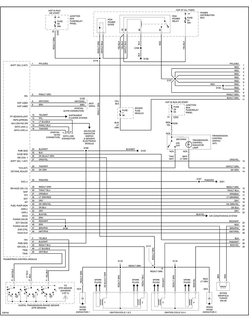

I have a 97 ford f-150 4x4 4.6 v8 5 speed. It is not starting. I thought it was the fuel pump and replaced it. Instead its not firing at all. no spark! how do i check to eliminate the problem. I really hope its not the computer. If someone could help me out i would be totally grateful!
