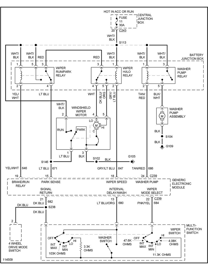

I recently bought this 1999 F150 and after I had it I noticed the Odometer works intermittenly, then the Over Drive kept popping breakers, then the Dash Lights kept popping breakers, then the windshield wipers would just come on for about 2 cycles.
Is there any
Overdrive
Dash Light
Wiper schematics that I can access to maybe help in tracking down my problem?
I tried to use the hanes schematics but they do not really show me much.
