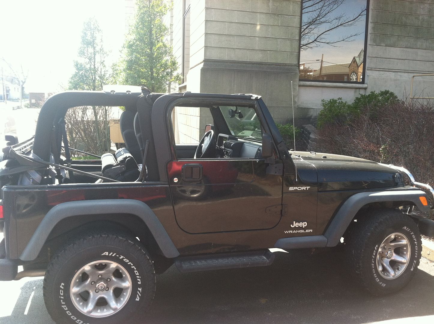

You're quite welcome! This is, as a matter of fact, a subject I am intimately familiar with.
The wife's broom, er, ride.
