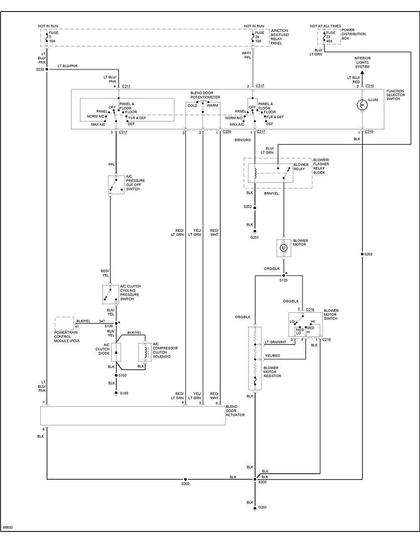

I got a tip and hit the compressor with a hammer while it was running and it spun for a second and went right back off so I don't think it's the fuse, but still no ac.
