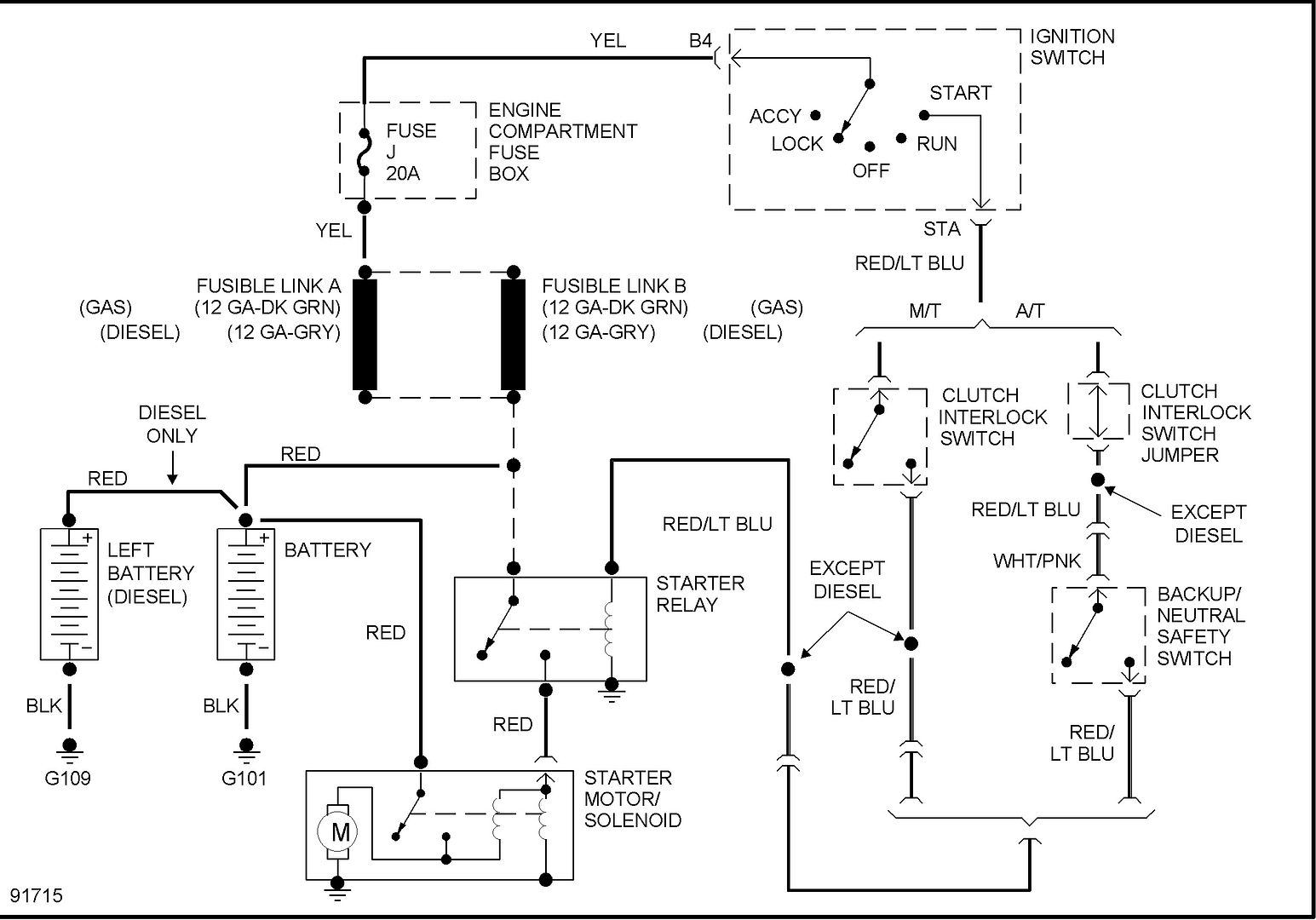

A couple of things came to mind; the starter relay but that should be attached to the starter for that year and if the starter was replaced the relay should have been a part of that.
The other thing was maybe one of your fusible links or the relay is going bad.
See less See more
Hi Mac,
I will try replacing the fusible links and see what happens. Thanks very much for your help!
Adam
I had similiar problem with my 93 f-150 automatic 4.9l mine though was a bad battery terminal. I get power everywhere until I turn the key and Click then I lose all power till I release the key and power comes back on. sometimes I never lost power at all. it was the cable from positive terminal to the starter that was making a poor connection. To be specific it was a stripped bolt on positive terminal
I have a 97 F150 that is doing the same thing right now i have cleaned all the connections changed the termanals and the startor but it is still sitting in my yard like a lawn orniment.. mine makes a small clicking noise when i turn the key but nothing happens. if i figure it out ill post my findings.. lol
