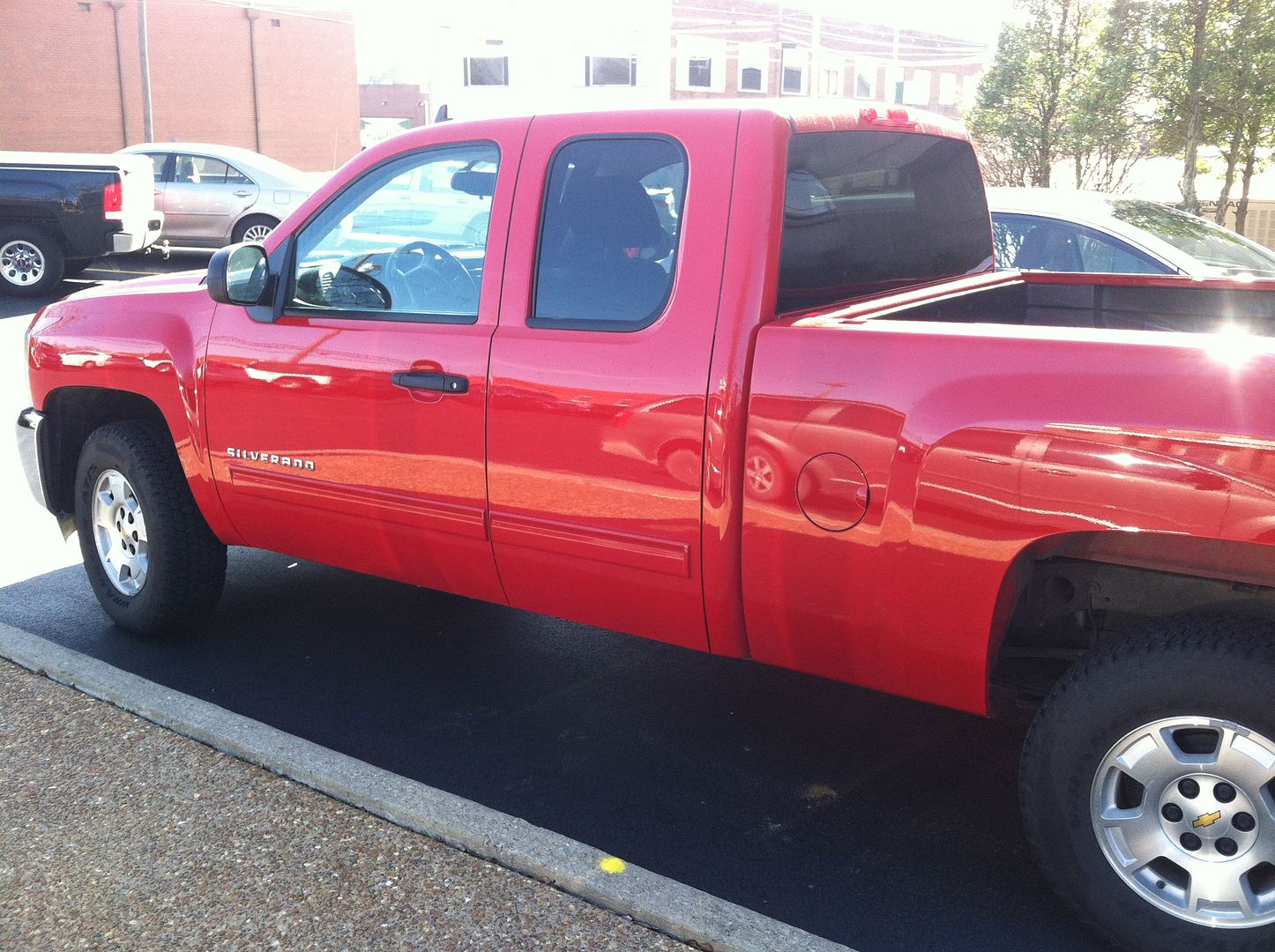

The Rental
The rental truck feels like a tin can! While it's pretty (sorta), it just doesn't feel right.
